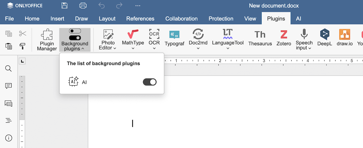

Explore the concept of the bundled plugin type in ONLYOFFICE. Such plugins remain active across all open documents and even persist in newly opened ones until you manually disable them. Simply click the Background plugins button on the top toolbar to manage them. Examples of such plugins include AI and QR Code Generator.
A plugin is considered bundled if:
- it is included in the product distribution (server/desktop);
- it has not been updated, removed, or disabled.
Starting from version 9.0.4, bundled background plugins start immediately.
